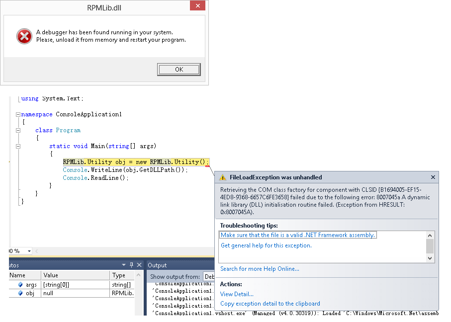

Hi,
I have used VMProtect to protect a COM DLL,
on .NET 3.5, it is ok to add a COM reference and run it without popping up 'A debugger has been found .. unload it ... '
however, on .NET 4.0, i tried different COM properties without luck, it always disables the COM object calls.
any ideas? I don't want to generally disable the 'checking' of the debugger on VMProtect.
Thanks.
