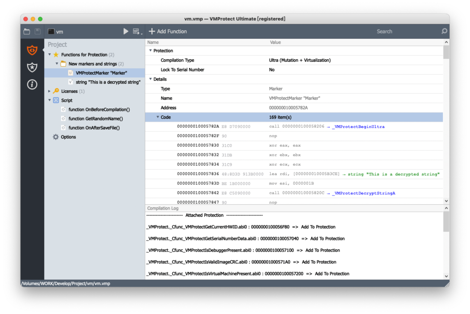

If use CGO, VMP does not recognize Marker and the string need to encrypt,
After a while of research, I solved the compatibility of some VMProtect with Golang.
:D Now VMProtect can recognize the address of VMProtectBegin and VMProtectEnd.
MarkerName and the string need to encrypt all can be detected(work well on mac and win).

Test work well on window 11 and Mac OS 12.3.1 (Go 1.18.1)
