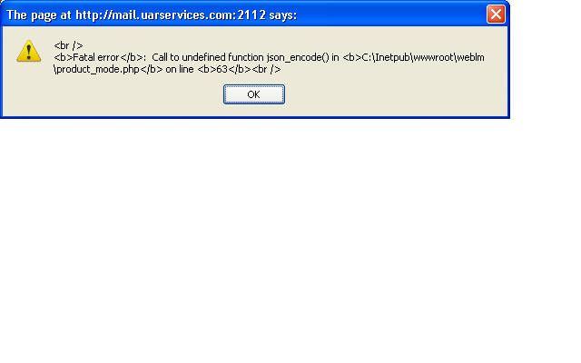

More info:
I restarted the server and my product I was trying to add was there!
So I tried to add a mode and upon saving the mode, got an error dialog.
It is very unstable it seems and something needs a tweak.

Post by bitman2112 »
And that error dialog box boys and girls, was a need to have at least PHP 5.20!
Git 'er done!
