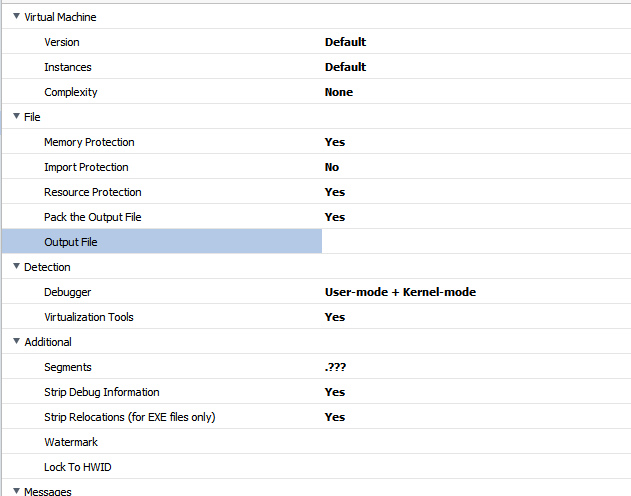

When I use the default configuration of 3.8, the output exe starts slowly on some computers, and some even take a few minutes. When I switch to VMProtect 2. X, there is no problem. Attachment is my settings. Is there any way to solve this problem? In addition,What is the specific difference between default and VMProtect 2.X?
Please try the 1681 build.
This is old VM from 2.X version. We strongly recommend to use the "Default" VM version with Complexity >= 20%. Also you can specify different Complexity value for each function with "Virtualization" or "Ultra" compilation type.

Shzc wrote:When I use the default configuration of 3.8, the output exe starts slowly on some computers, and some even take a few minutes. When I switch to VMProtect 2. X, there is no problem. Attachment is my settings. Is there any way to solve this problem? In addition,What is the specific difference between default and VMProtect 2.X?
if i can suggest. On entrypoint put only mutation. or at latest virtualization try it few time and see which one speed up code execution of your software. also as the admin suggest try last bulld. which works perfectly!
