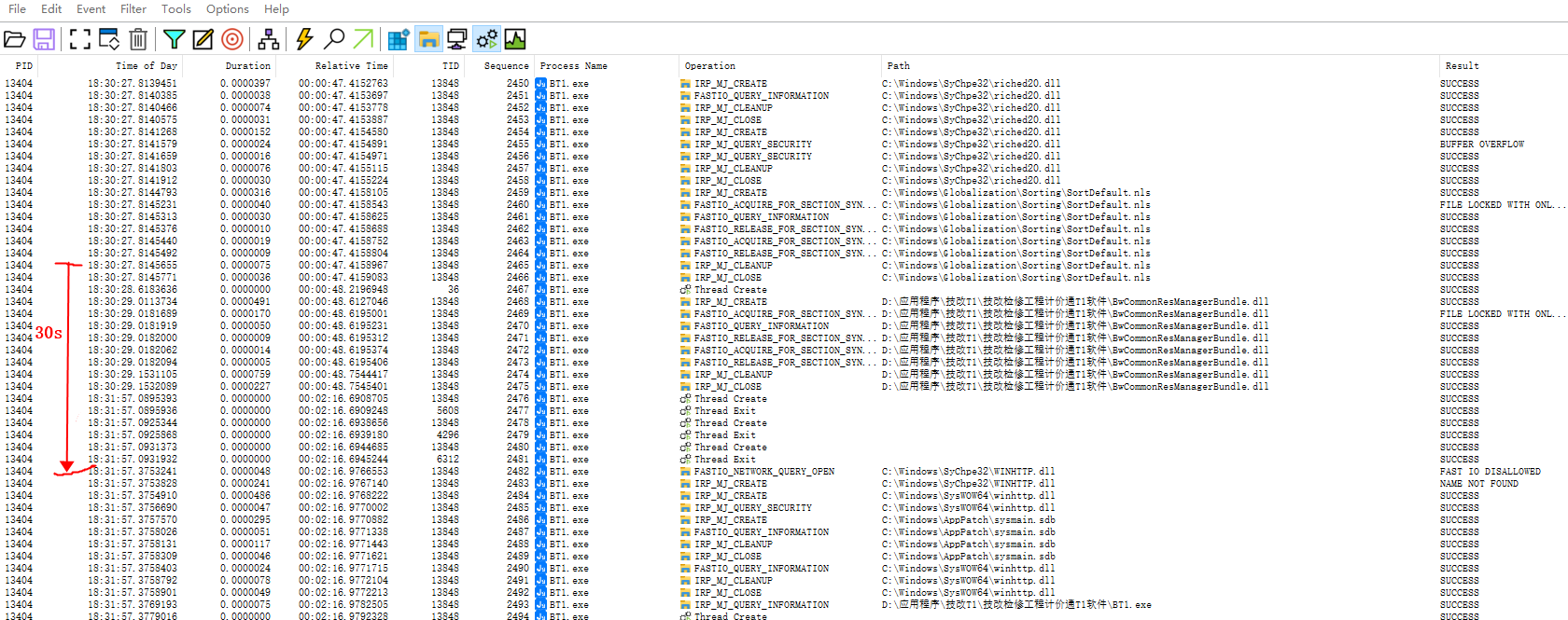

The performance of loading vmprotect3.8.2 shell loaded DLL during process startup on WIN10 ARM is very slow.
Under x86, it only takes 3 seconds, while under arm, it takes more than 3 minutes.
I will not encounter this issue if I use vmprotect3.6.0 as a shell, and the performance is very fast.
Please confirm if there are any performance issues with version 3.8.2 on the Win10 arm system.
The following is the relevant information collected:
BwCommonResManagerBundle.dll is protected by vmprotect3.8.2 and has been disabled without options such as memory verification, compression, checking debuggers, checking virtual machines, and resource protection.
The entire performance log.
vmprotect_arm.zip
(3.47 MiB) Downloaded 369 times
