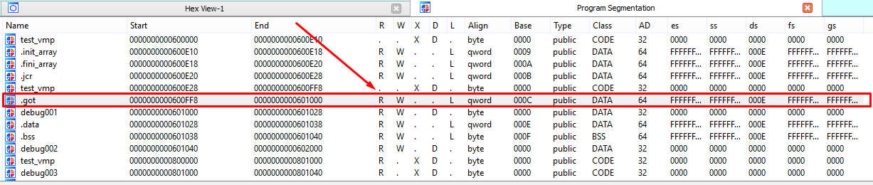

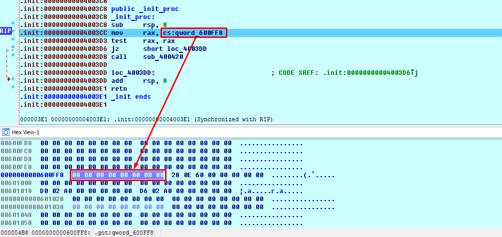

It seems the problem at the server side (looks like a bug in CPU):
4003CC: got SIGSEGV signal (Segmentation violation)
- Screenshot_3.png (25.86 KiB) Viewed 10481 times
- Screenshot_4.png (38.05 KiB) Viewed 10482 times

GDB also shows accessible memory region at 0x600ff8:
[centos@xxxx ~]$ gdb ./test_vmp
GNU gdb (GDB) Red Hat Enterprise Linux 7.6.1-110.el7
Copyright (C) 2013 Free Software Foundation, Inc.
License GPLv3+: GNU GPL version 3 or later <http://gnu.org/licenses/gpl.html>
This is free software: you are free to change and redistribute it.
There is NO WARRANTY, to the extent permitted by law. Type "show copying"
and "show warranty" for details.
This GDB was configured as "x86_64-redhat-linux-gnu".
For bug reporting instructions, please see:
<http://www.gnu.org/software/gdb/bugs/>...
Reading symbols from /home/centos/test_vmp...(no debugging symbols found)...done .
(gdb) r
Starting program: /home/centos/./test_vmp
Program received signal SIGSEGV, Segmentation fault.
0x00000000004003cc in ?? ()
Missing separate debuginfos, use: debuginfo-install glibc-2.17-222.el7.x86_64 li bgcc-4.8.5-28.el7_5.1.x86_64
(gdb) x/i 0x4003cc
=> 0x4003cc: mov 0x200c25(%rip),%rax # 0x600ff8
(gdb) x/g 0x600ff8
0x600ff8: 0
Re: linux program protected by vmp 3.1.2 crash directly in c5 series instance of AWS

Because AWS C5 has bug in its CPU. I have already shown it - "_init_proc" belongs to your original program (it isn't the VMProtect code). The bug appers in Skylake after changing memory attributes of the first segment.I tried a lot of machines, test_vmp can work properly, except for some machines.
