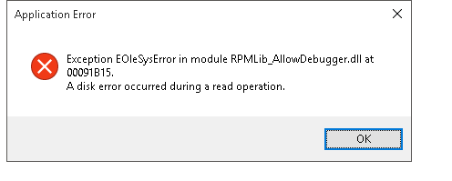

Re: Questions on VMProtect 3
after I switch off 'memory protection'
it shows this error.
This error has been fixed in 3.0.1.465. Please check it.
