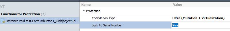

Re: VMProtect v3.7.2 build 1530 - .NET application crashes with Import Protection
Do you use the "Lock To Serial Number" feature?
I mean the following code:
[Obfuscation(Feature="virtualizationlockbykey" ...)]
It looks like this:
Please try the 1533 build.
